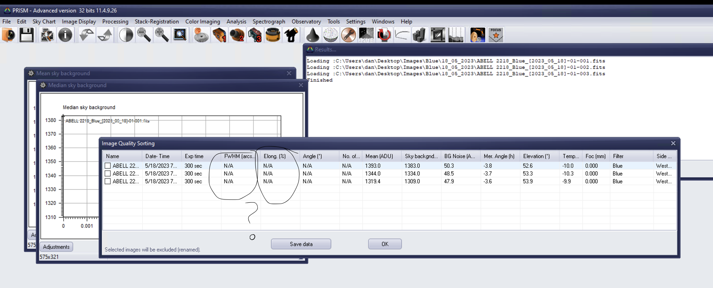

Hello,
I am using the English version 11 of Prism.
When I select Analysis -> Quality check (stelar images), the resulting table does not compute the FWHM of my stars in a few images.
How do I set Prism to compute the FWHM of stars in the image?
Thank you.

- Messages : 1326
Re: FWHM values for images
No problem with yours images (Prism 32 bits version 11.2.3.21)
Centroid Settings:
Analyze Settings:
Results:
Centroid Settings:
Analyze Settings:
Results:
Thank you I will try with those settings. My original settings was with "whole image". I will try 1/2 central zone
dan_adrian
- Messages : 38
- Enregistré le : 09 août 2021, 10:03
I tried your settings Marc . In order to compute the FWHM, I have to check the option "Seeing computation area defined as above"("Caculs de seeing Sur zone define ci dessus").
With that option checked everything works.
Thank you.
Thank you.
