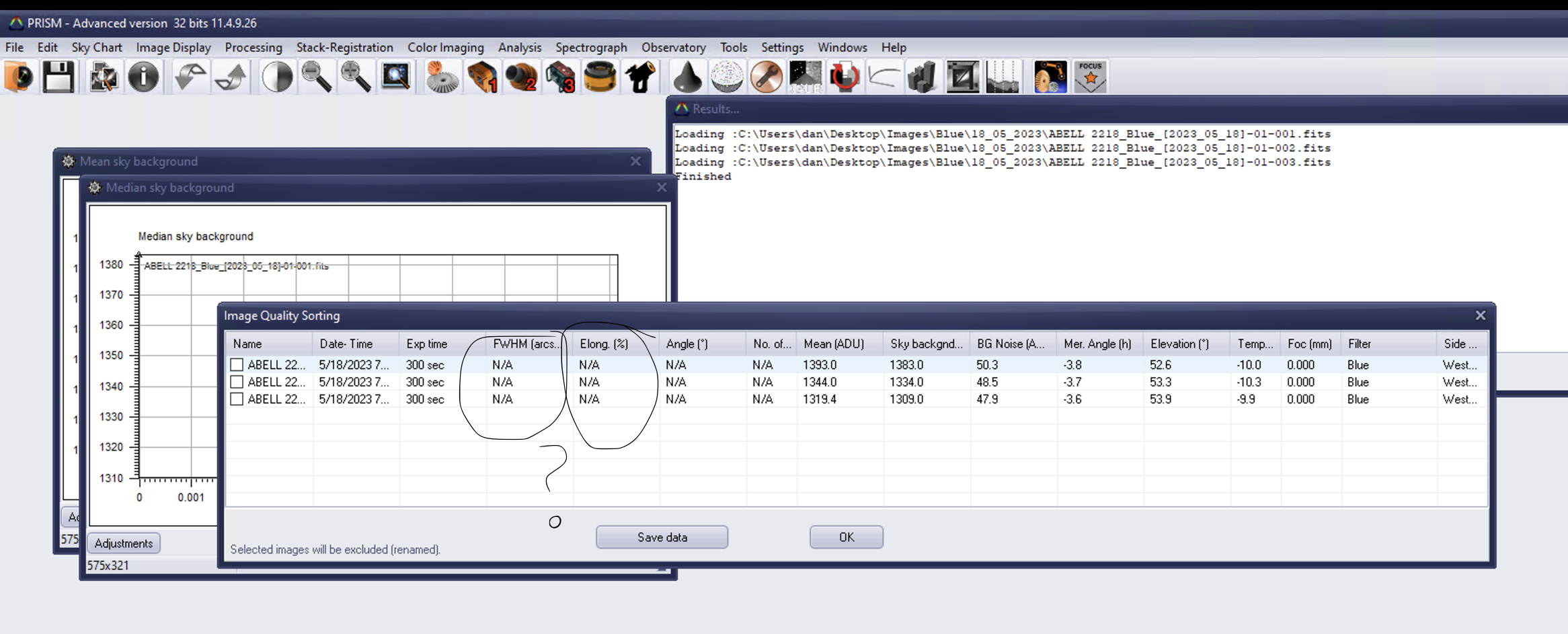

Hello,
I am using the English version 11 of Prism.
When I select Analysis -> Quality check (stelar images), the resulting table does not compute the FWHM of my stars in a few images.
How do I set Prism to compute the FWHM of stars in the image?
Thank you.

I need to see an image. Please share one.
If you have a FWHM > 15 pixels this will not work and indicate that you MUST bin your image and have a proper sampling rate.

No problem with yours images (Prism 32 bits version 11.2.3.21)
Centroid Settings:
Analyze Settings:
Results:

Thank you I will try with those settings. My original settings was with "whole image". I will try 1/2 central zone

I tried your settings Marc . In order to compute the FWHM, I have to check the option "Seeing computation area defined as above"("Caculs de seeing Sur zone define ci dessus").
With that option checked everything works.
