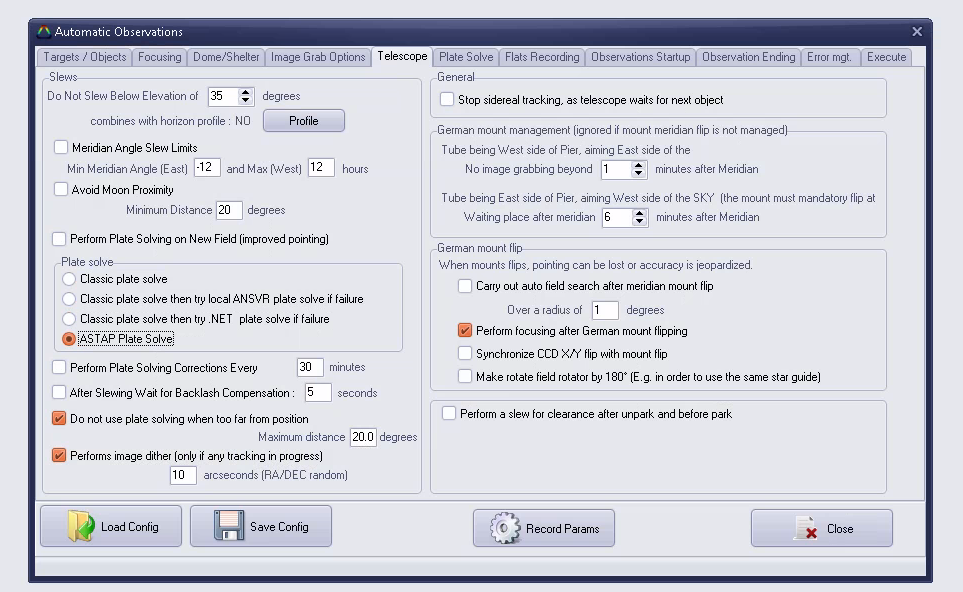

Under Telescope I have:Dekelver Pieter-Jan a écrit : ↑17 janv. 2024, 09:47 Yes, you can disable platesolving in the Automation setup.
Under "Telescope" you can deselect platesolving.
Platesolving is not needed for prism to take images of an object. It slews to the wanted object, and just start imaging.
Plate solve:
1. Classic plate solve
2. Classic then local ANSVR
3. Classic then .NET
4. ASTAP
I can't deselect all, I have to choose one.
Did you mean another option?
Below is my Telescope config window
Re: Can I disable plate solving in automatic observation?
The checkbox above the radio group box is deselected, so this should not occur.
