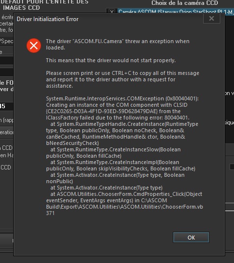

Dear,
I encounter a problem with PRISM 11.4.22.39 32-Bits and 2 FLI Microline cameras using the ASCOM reader inside PRISM
ASCOM main driver: 662.4294
ASCOM driver from FLI: V6.5.8325
FLI MIcroline KAF3200ME
FLI Microline KAF16803ME
When trying to launch two cameras inside PRISM with the ASCOM driver, the error attached arises.
Both cameras can be controlled from the FLI Pilot program or previously there was no problem using the Microline KAF3200ME only inside PRISM using ASCOM mode.
Only after trying to setup the second camera as FLI MIcroline KAF16803ME the problem occured and there is appearently no way back.
When trying to select the camera using the ASCOM properties window, the error arises. I tried reainstalling both ASCOM main driver aswel as the ASCOM FLI driver,
but again the same error comes up. Inside PRISM there is some kind of build in FLI selection witch i just tested, and there i can connect both cameras succesfully.
I did a temperature readout with graph for 30 minutes, and no connection error or anything camera up.
So what is the problem with the ASCOM driver?
Thank you.

It is at object creation so immediate.
Look like driver installation problem.

I still encounter this problem. FLI has updated a new driver and still this problem occur.
I have reinstalled ASCOM main and drivers. I don't think / hope i need to reinstall PRISM?

Try the latest ASCOM platform.
