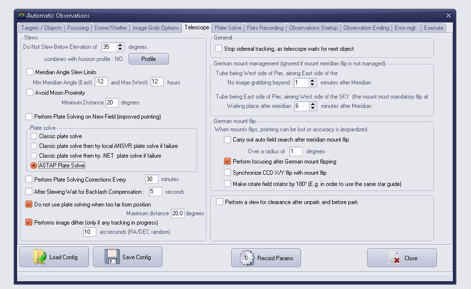

Under Telescope I have:
Plate solve:
1. Classic plate solve
2. Classic then local ANSVR
3. Classic then .NET
4. ASTAP
I can't deselect all, I have to choose one.
Did you mean another option?
Below is my Telescope config window
Re: Can I disable plate solving in automatic observation?
The checkbox above the radio group box is deselected, so this should not occur.
