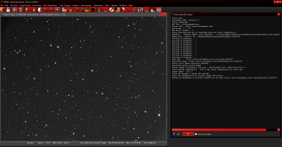

1. During the plate solve process with Nova.astrometry.net the final solved image from Nova.astrometry.net does not uploaded.
I am not able to paste Prism image from my pc to forum.

OK I've the same issue.
The last Prism release [V 11.4.35 (19/08/2025)] was supposed to fix this issue, but that does not seem to be the case :
[ChangeLog]
* Astrometry.NET : Resolution of a bug related to changes on the server where it is no longer possible to automatically retrieve the annotated image.
I no longer use Astrometry.net but ANSVR (astrometry.net locally on the machine) and everything is OK.
I recommend switching to ANSVR or ASTAP.
[ChangeLog]
